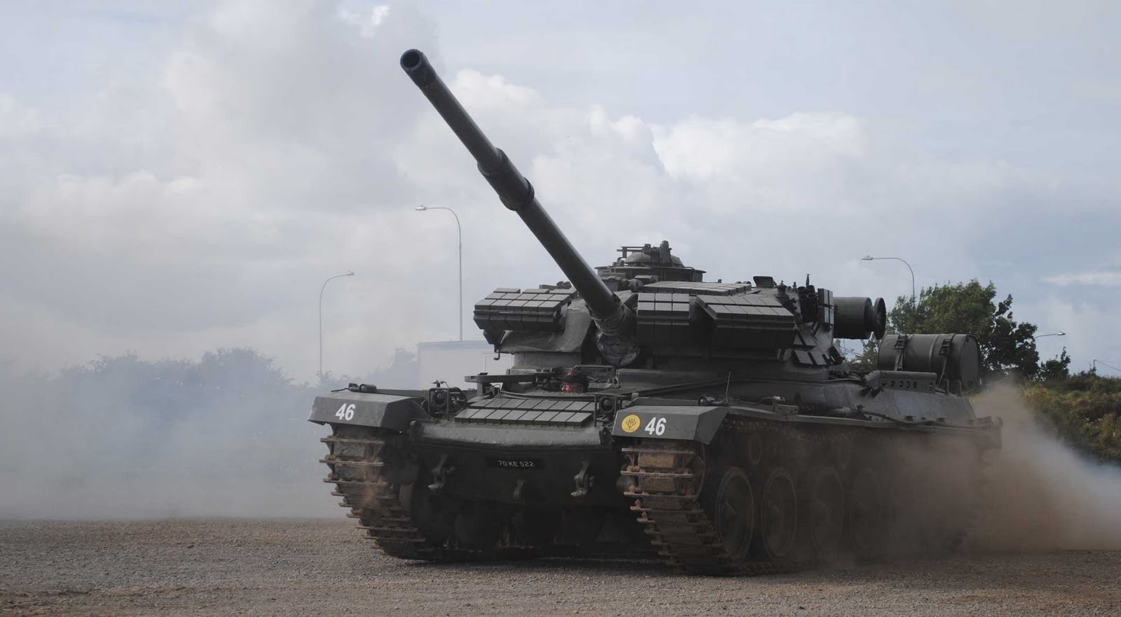

http://4.bp.blogspot.com/_3G1mLwS-UTM/TH2at1qRVGI/AAAAAAAAAFA/km2CLWVyxxg/s1600/DSC_1252.jpg
такой вот vismod  :crazyfun:
