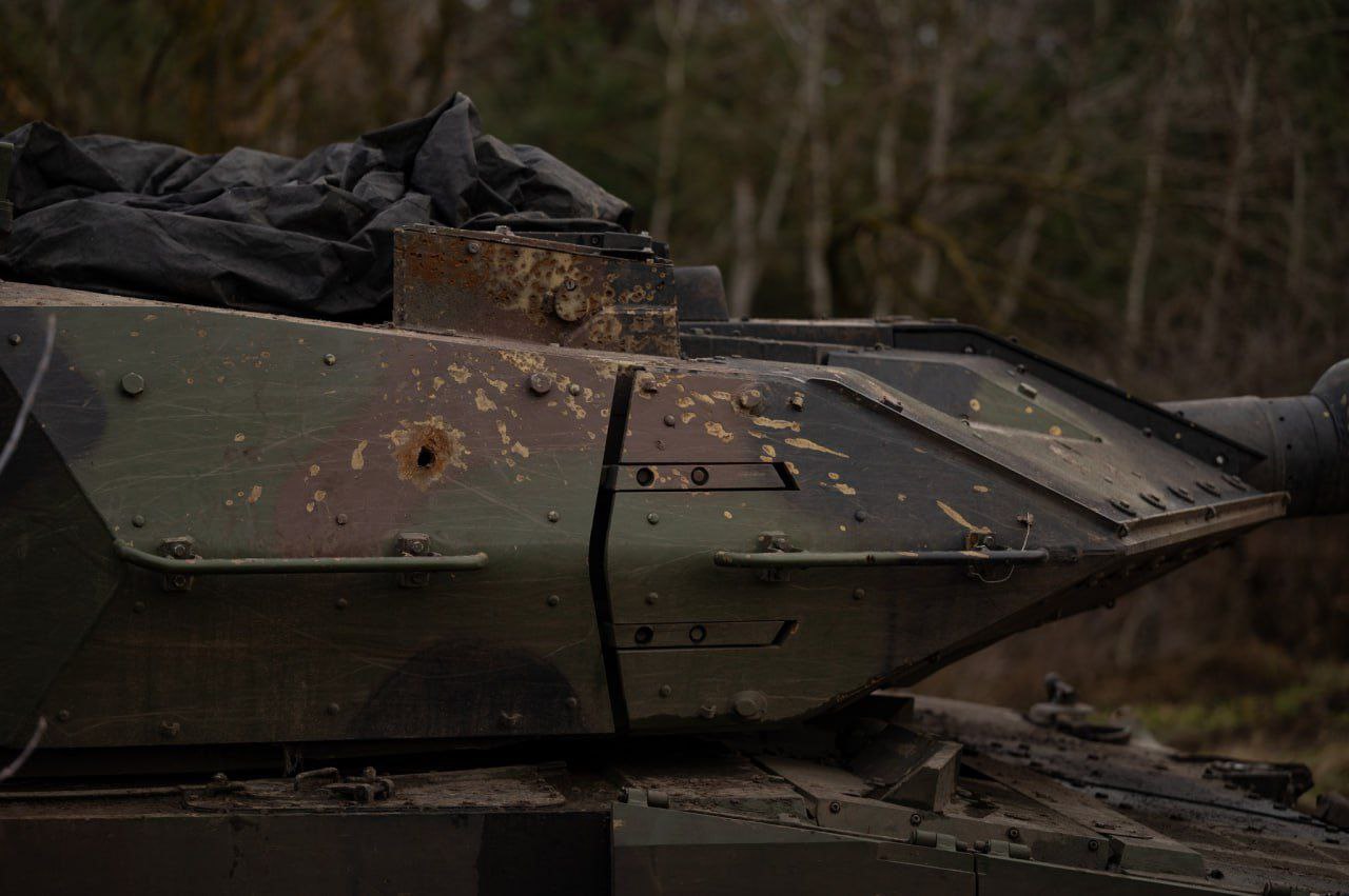

Украинский танк Leopard 2A6 со следами попадания ПТУР в башню.

6
а не рпг ли?
7
По моему это мелкашка какая то

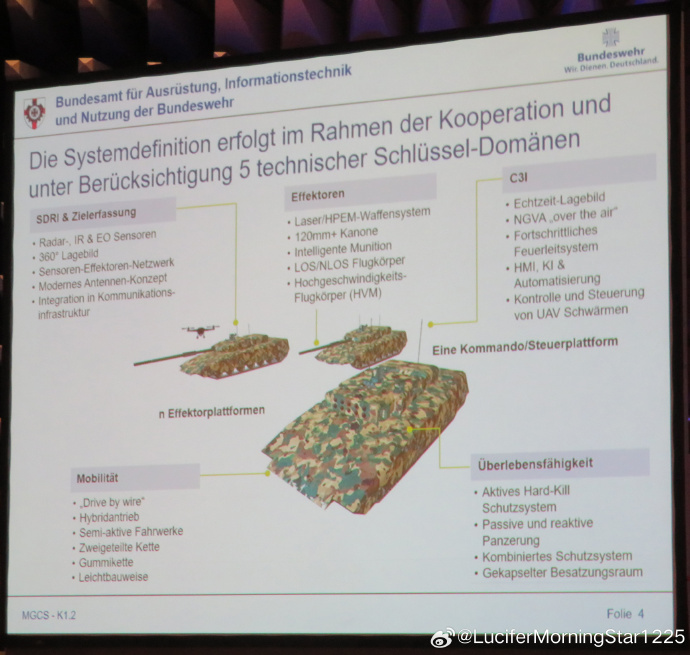

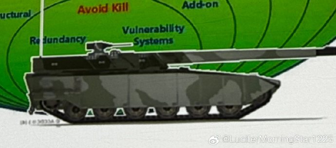

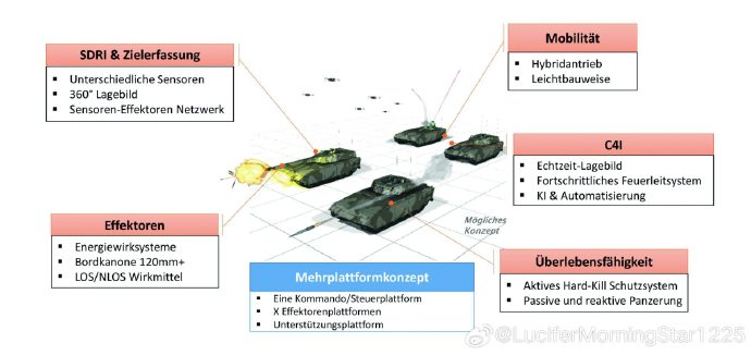

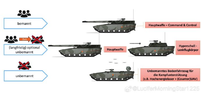

По недавно прошедшей IAV2024
Ну и статья
На английском
A senior Bundeswehr procurement officer, speaking on 23 January 2024 at the Defence iQ International Armoured Vehicles conference in Twickenham, outlined how Germany’s vision for the future Main Ground Combat System (MGCS) project has moved from a single tank design to a multi-platform solution.
Noting a German emphasis on “mobility, mobility and mobility” as the overriding MGCS consideration, Colonel Armin Dirks, Head of Operations for the MGCS Combined Project Team within the Federal Office of Bundeswehr Equipment, Information Technology and In-Service Support (BAAINBw), said, “From our point of view, the time for a single all-in-one platform is over.”
Citing Lieutenant General Andreas Marlow, the vice chief of the German Army, who had earlier noted that in future the tank has to provide more capabilities than it does now, Col Dirks said, “At a very early stage we learnt that if we want to integrate all these future capabilities on a single platform like before, like we have right now, we would end up [going even larger] with the respective size, and at that time the chief of the army said, ‘No way: 50 tonnes; not a single drop more.’”
Thus, said Col Dirks, “We had to leave the capability analysis focusing on a single platform behind and go to the requirement analysis of the formation, put together all the requirements the future system has to provide.”
The colonel then presented a conceptual image showing a formation of three AFVs that were each smaller than an MBT. He explained that the two leading AFVs, one of which was armed with a main gun and the other with a missile launcher, would be unmanned, while the AFV behind them would be manned and act as the control vehicle.
Regarding other design considerations, Col Dirks noted that all three vehicles would need to share the same chassis to minimise their logistics footprint, while a considerable degree of automation would both reduce crewing requirements and improve lethality.
Thus, the MGCS project under the German concept now appears to start with a 50-tonne unmanned ground vehicle (UGV), which, combined with other platforms, fulfils the complete set of capability requirements that could not otherwise be encompassed within a single MBT. The colonel additionally noted thus such a multi-platform solution offers a particular advantage, in that, if in future a new capability needs to be introduced, another vehicle can be added to the formation rather than further burdening the vehicles already in it.
While again stressing the importance of mobility within AFV design’s ‘iron triangle’ of firepower, survivability and manoeuvrability – to keep the enemy busy and present that enemy with new dilemmas – Col Dirks added three key enablers: surveillance, detection, recognition and identification (SDRI); command, control, computers and intelligence (C4I); and sustainability.
The colonel additionally noted that in terms of energy management, fuel consumption and reducing the logistics footprint, the new MGCS AFVs would need to use a hybrid power unit. “We need to open that door,” he said.
Meanwhile, because the AFVs’ SDRI range would need to exceed their own firepower range, the colonel said they would require their own unmanned aerial vehicles, since their SDRI requirements could not be achieved with platform-based sensors. 
Moreover, for survivability considerations and because the new AFVs might have a smaller ammunition loadout than a Leopard 2 MBT, Col Dirks said the AFV with the main gun would need the technology to secure “more one-shot kills”. 
The Bundeswehr’s concept under the MGCS project has now moved to a multi-platform solution, combining both manned and unmanned AFVs to fulfil all the future requirements that would otherwise have to be accommodated by a single MBT. (Photo: P Felstead. Illustration: BAAINBw)
“So we need that,” said Col Dirks. “We need a game changer – not a linear extrapolation of what we have right now, only an improvement; what we need is to restart because the Leopard 2 deserves its retirement in a couple of years and we need something new, with which we can start again, of a lower size, a lower weight and then have the growth capability for the future.
“In 2050 the Leopard 2 will then be in service 50 years [Editor’s note: having entered service in late 1979, by 2050, the Leopard 2 family will in fact have been in service for over 70 years.], and so we look to the future system, the successor system, to use at least until the end of the century,” the colonel added. “Therefore, we need to widen our view a little bit.”
The MGCS project was launched in 2017 by Germany and France to replace their respective Leopard 2 and Leclerc MBTs. It was originally to be developed by KNDS, a joint holding company set up in 2015 by Germany’s KMW and France’s Nexter Systems. However, German firm Rheinmetall joined the MGCS project in 2019 and it remains to be seen whether German and French views on what the programme should produce can remain aligned.

9
Ну и статья
Гуглом:
Снижение веса до 50 тонн – более компактная конструкция
- Мобильность, мобильность, мобильность – высокое соотношение мощности и веса
- Системный подход - общая платформа с различными типами, включая танк, ракетную пусковую установку и беспилотный ведомый ПВО.
- Вероятно, будет иметь орудие большего размера - 130 мм или 140 мм и способность вести огонь ПТУР NLOS.
- Башня необитаемая
- Экипаж из трех человек, расположенный в корпусе
- КАЗ/Система ПВО ближнего радиуса с защитой верхней полусферы
- Гибридный электропривод мощностью 1800 л.с.
- Пассивная и динамическая защита

Упд, тут еще у китайцев
Концептуальная схема, которой поделился ”Плохой старик" (рис. 1), на самом деле очень старая и неоднократно использовалась в материалах BMVg PPT (рис. 2, рис. 3, рис. 4); кроме того, в дополнение к немецкой версии Rheinmetall (рис. 7), французская версия DGA (рис. 8) и немецкая версия Hensoldt (рис. 9), также существует модель рендеринга от Nexter во Франции (рис. 6).
