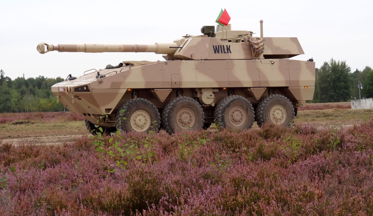

http://4.bp.blogspot.com/-o5BZzeL2o-w/VAePeBo_c5I/AAAAAAABB7I/llppVNwG9uo/s1600/Fire+support+Vehicle+Wilk.JPG http://3.bp.blogspot.com/-DVVh87lyV50/VAePd3H0-QI/AAAAAAABB7E/T_XKqqjgzOs/s1600/Fire%2Bsupport%2BVehicle%2BWilk..jpg
