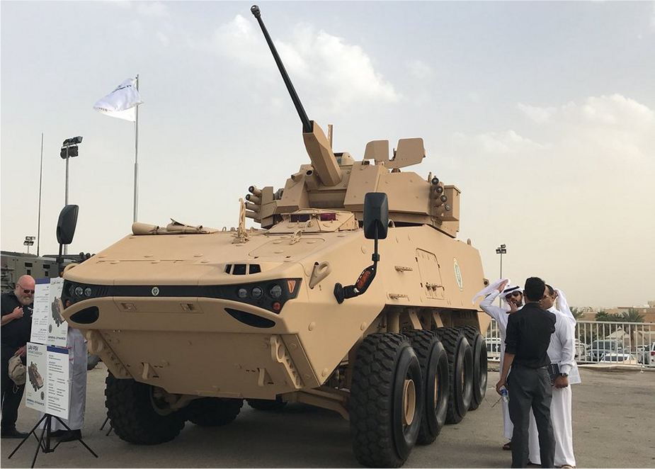

https://4.bp.blogspot.com/-x-I9cSPbZOU/WqZhL3KUyUI/AAAAAAAAc94/faVVOKPl_os5tS4U0wxi9gOakwhTjmd-ACLcBGAs/s1600/New_LAV-FSV_8x8_armored_ADEF_2018_defense_exhibition_in_Saudi_Arabia_925_001.jpg
LAV-FSV
