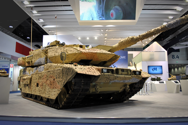

2A7+(НЯП в Катарской версии) на стенде KMW(у Rheinmetall стоял 2PL)на IDEX 2017
https://www.shephardmedia.com/media/images/article/leopard-2a7-qatar-resized.jpg
http://static.gulfnews.com/polopoly_fs/1.1981762!/image/695124653.jpg_gen/derivatives/box_790522/695124653.jpghttps://pp.userapi.com/c637418/v637418604/2fb04/hlXhgvGn-90.jpg
https://pp.userapi.com/c637418/v637418604/2fb0d/s1IntzGAbLw.jpg
