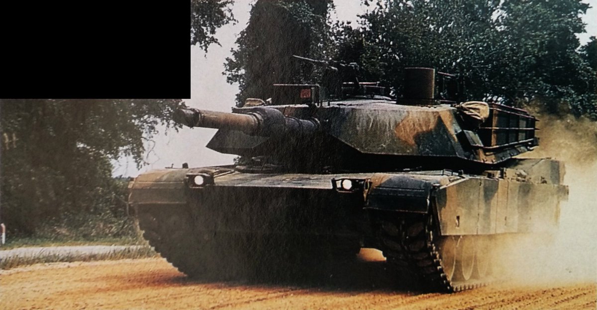

M1A1. Тепловизионный канал основного прицела (Gunner’s Primary Sight (GPS)), 1 поколение, линейка, 120 элементов.
16.12.2002 г., Кувейт. В окуляре M1A1. Отсюда. Кликабельно.

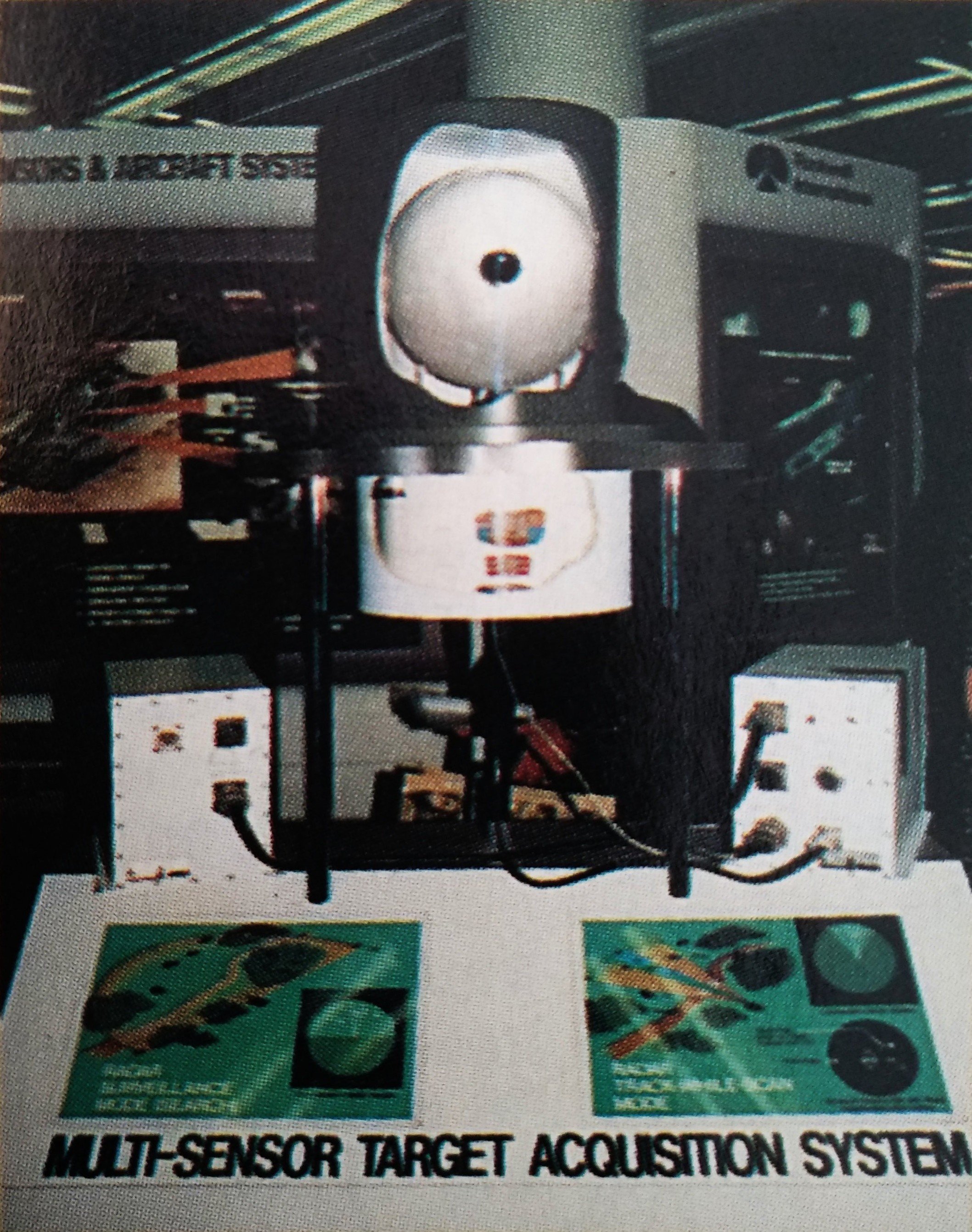

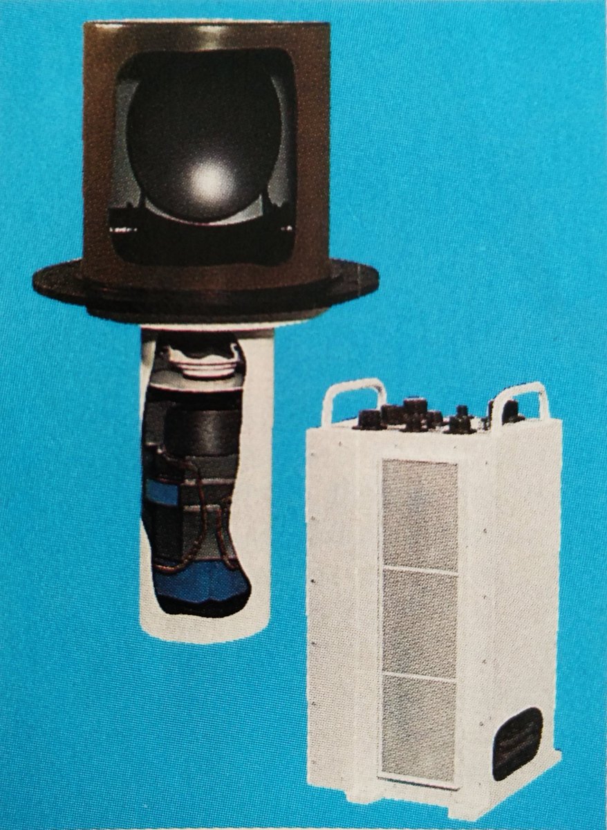

Радар для М1 и Block III
Rockwall was recently awarded an approximately $9 million 24-month contract by the US Army to deliver a prototype MTAS (Multi-sensor Target Acquisition System) for test and evaluation. The MTAS concept provides armoured vehicles with a variety of sensors for target detection, tracking, recognition and engagement in all kinds of weather. It basically adds a millimetre-wave radar to the tank's existing FLIR, sight and laser rangefinder to provide a totally integrated system. The low-probablllty-of-intercept millimetre-wave radar uses an extremely narrow beam as well as employing frequency-hopping and other ECCM techniques. The radar's antenna assembly is mounted topside on the tank turret, while its electronics, digital processor and display are mounted inside the turret. The exposed portions of the antenna are protected by an armoured shield. Next phase in the program would be to proose on upgrade package for the M1 Abrams MBT. According to Rockwell, MTAS 1, which would be the initial Abrams system, would fit in the same space as the current commander's CITV sight. MTAS 1 would allow the detection and engagement of both moving and stationary targets as well as firing-on-the-move.
