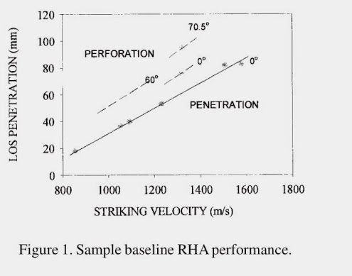

Объяснение того, почему 60-больше:
A typical long rod penetrator can completely perforate a greater thickness of armor than it can penetrate. This is attributed to the break out phase of a finite thickness plate. As the penetration approaches the rear free surface of the finite plate, the target fails, either by ductile failure or shear failure, which requires less energy for the penetrator than if it were to continue in a steady state penetration mode. Also, as the obliquity of the finite RHAis increased, the line-of-sight (LoS) thickness that can be perforated at the same ve-locity also increases. The rear free surface of the plate is reached earlier in the penetration process for higher obliquity plates [3]. These trends in performance are illustrated in Fig. 1, a plot of LoS thickness of the armor as a function of impact velocity. As can be seen, the penetration curve lies lowest on the plot. The finite thickness data, perforation data, lies higher on the plot and increase with increases in obliquity. This graphi-cally shows that for one velocity, a ty-pical long rod penetrator will perfo-rate more than it can penetrate and also will perforate more at obliquity than it does at normal impact (0° obli-quity). Because of these actors, it is desired to have the baseline RHAper-foration curve for the same obliquity as the armor being evaluated. Ob-viously, from the differences in these curves, the RHA-e is going to be highly dependent on the baseline curve used
