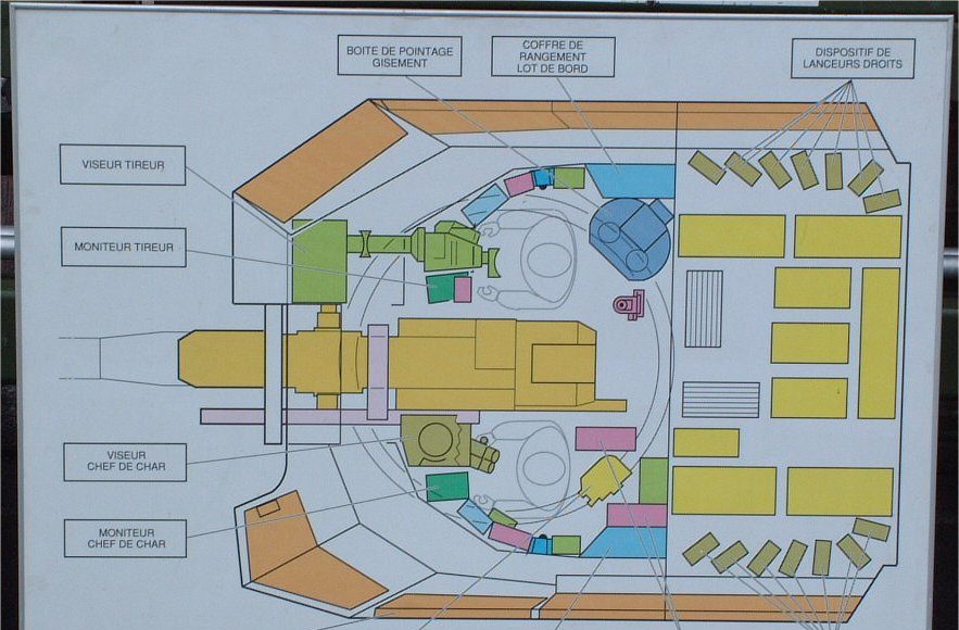

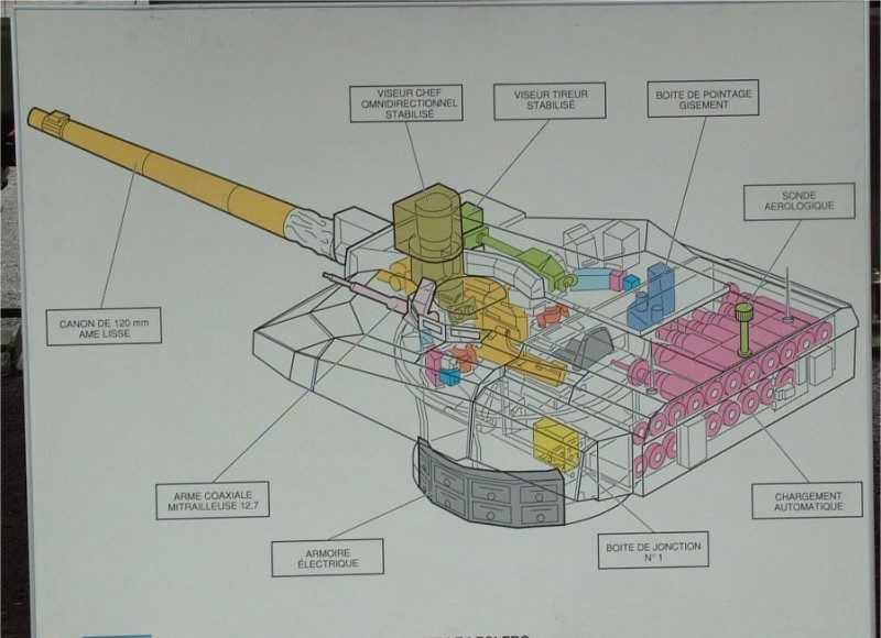

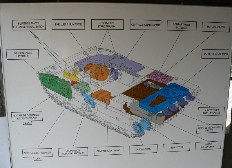

Было здесь такое?
https://www.militarypedia.it/wp-content/uploads/2016/07/Leclerc_foto25_infografia-800x580.jpg
https://www.militarypedia.it/wp-content/uploads/2016/07/Leclerc_foto21_infografia-800x580.jpg
https://www.militarypedia.it/wp-content/uploads/2016/07/Leclerc_foto23_infografia-883x580.jpg
https://www.militarypedia.it/wp-content/uploads/2016/07/Leclerc_foto22_infografia.jpg
