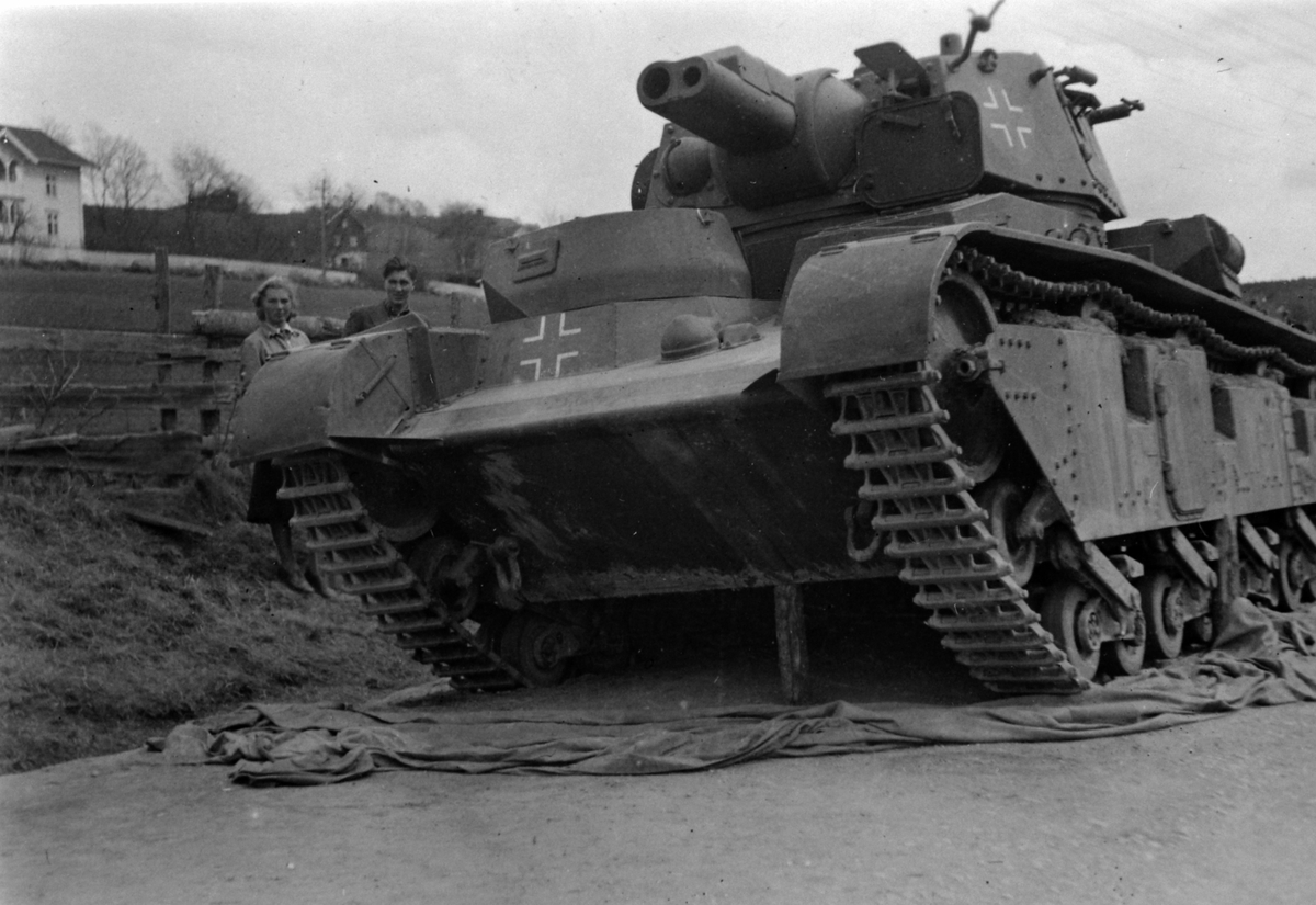

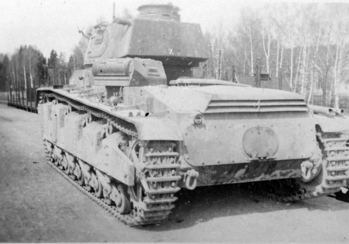

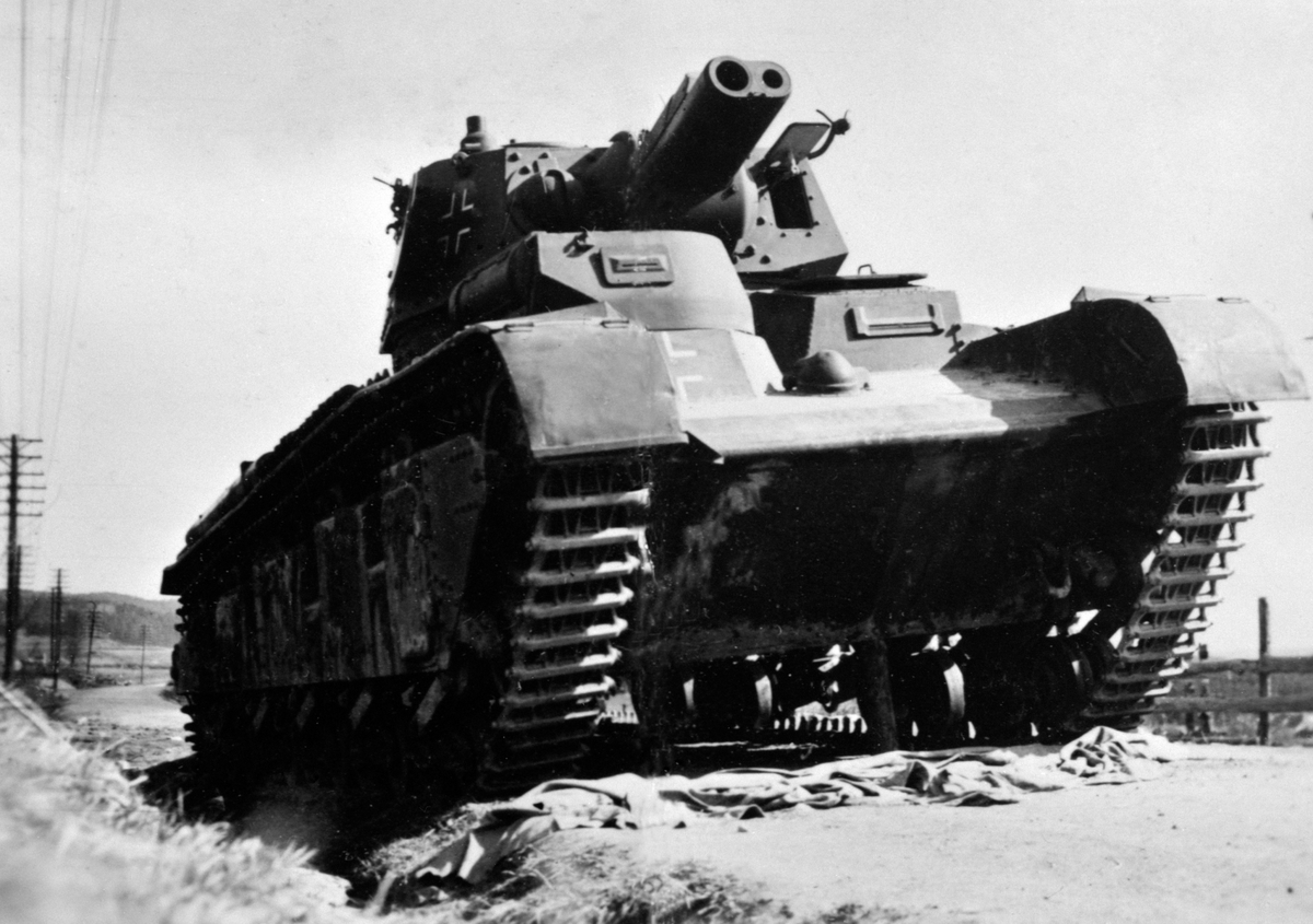

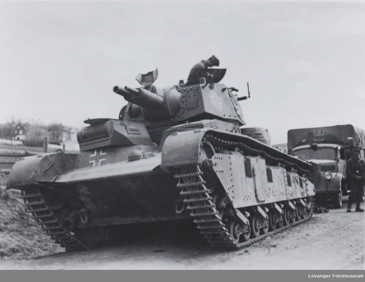

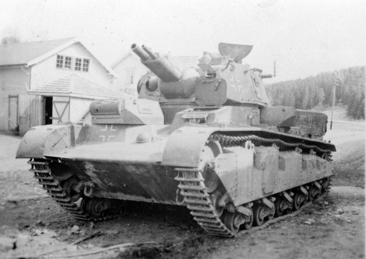

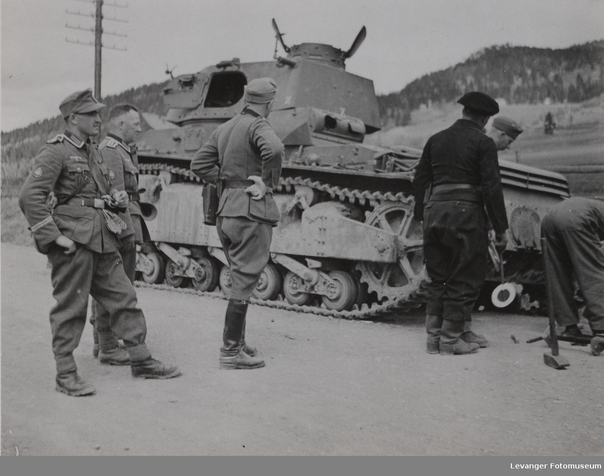

660
http://dms01.dimu.org/image/012uMX4LMQKv?dimension=1200x1200
http://dms09.dimu.org/image/02SVtZw6tg?dimension=1200x1200
http://dms10.dimu.org/image/03SVzxag14?dimension=1200x1200
http://dms07.dimu.org/image/03SVzxag9p?dimension=1200x1200
http://dms01.dimu.org/image/01SVzxag9n?dimension=1200x1200
http://dms01.dimu.org/image/02SVzxag9o?dimension=1200x1200
http://dms08.dimu.org/image/012uMX4LMQFW?dimension=1200x1200
http://dms01.dimu.org/image/012uMX4LMQFZ?dimension=1200x1200
http://dms08.dimu.org/image/04SVzxag9m?dimension=1200x1200
норвежский архив
