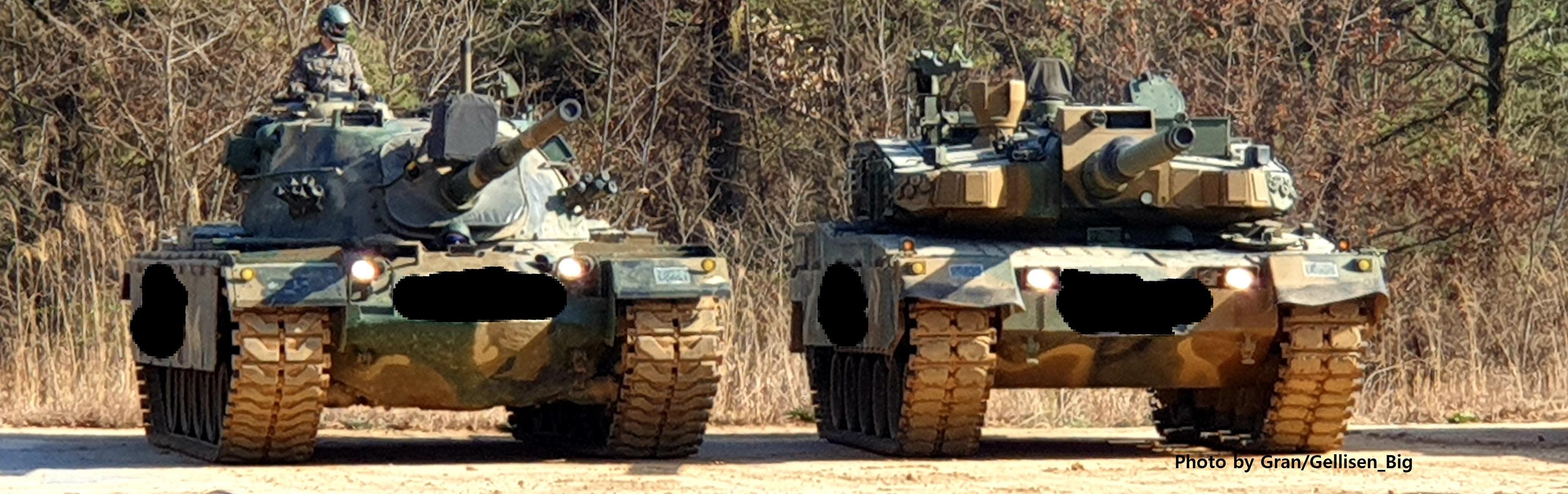

М48 и К2
https://pbs.twimg.com/media/ExZLPZbVIAUOWnj?format=jpg&name=4096x4096
via SH
