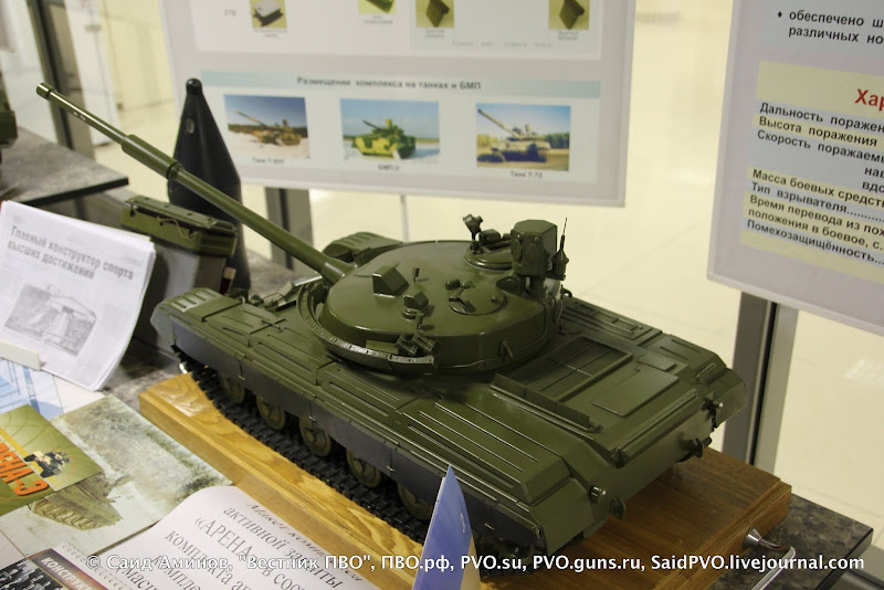

213
Модель Т-64 с Ареной.
https://lh6.googleusercontent.com/-dGrgrjxamrw/T4Z2928cNLI/AAAAAAAAITY/g_3gy4VsQI4/s800/IMG_6882.JPG
https://lh5.googleusercontent.com/-_qiCI8fyB2E/T4Z20htUefI/AAAAAAAAISc/yLJlnnUFSXA/s800/IMG_6875.JPG
http://saidpvo.livejournal.com/49465.html
